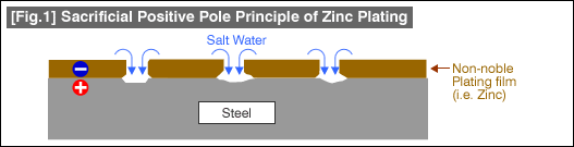

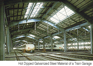

The most frequently used industrial plating for corrosion protection purpose are zinc (galvanizing) and tin plating. The zinc plating is used for corrosion protection of steels in natural environments such as air and water, and tin plating for the cans in the canning industry.
The zinc plating is the best known of plating less noble than steel. As shown in [Fig.1], this plating forms a cell with the steel being the positive and zinc being the sacrificial negative pole, protecting the steel from corroding. This is the same in principle as the sacrificial positive pole Corrosion protection scheme. The zinc plating film will eventually dissolve away and the steel will begin to corrode, therefore the corrosion resistance is proportional to the thickness of the zinc cell. This is in wide use as both hot dipped galvanizing and electroplating.
![[Fig.1] Sacrificial Positive Pole Principle of Zinc Plating [Fig.1] Sacrificial Positive Pole Principle of Zinc Plating](http://www.misumi-techcentral.com/tt/en/surface/images/074_1.gif)
