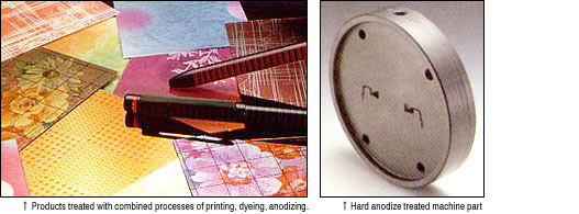

Anodizing is a surface treatment process of creating an oxidized surface layer by an electrolysis process where the subject part is made and anode (+ pole) in an electrolyte solution. Processed aluminum and its alloy parts are called by well know name of "Alumite".
The anodizing process using various electrolytes such as sulfuric acid, oxalic acid, chromic acid, or organic acid, as well as different temperatures and power source electrical waveforms will produce surface layers of different properties.
The oxygen produced at the anode produces porous layer with good electrical isolation characteristics, corrosion resistance, and wear resistant properties. The layer porosity is utilized for coloring as well as various functions added, and used for products such as reflector plates, household pots and pans, construction materials, automotive components, machinery/optical/communications, and computer components.
