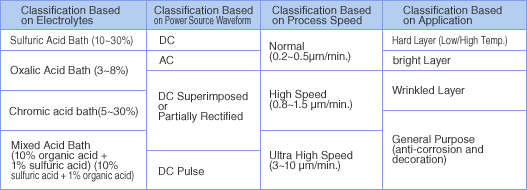

Various levels of anodizing difficulties based on different alloys exist and a number of schemes have been developed for the difficult alloys. Generally practiced anodizing processes are shown on [Table 1] below.
[Table 1] Types of Anodize Processes
There are virtually infinite number of industrial anodizing processes combinations as the [Table 1] suggests, based on bath types, power supply waveforms, process speeds, and application purposes.
Currently, the most common electrolyte type is the sulfuric acid bath. The reason for the popularity is that the formed layer is colorless, and the power supply voltage and power consumption required for the electrolysis is low and economical for colored parts production. For specialized colors and wear resistance requirements, oxalic acid bath layers and oxalic acid added sulfuric acid bath are used.
Of the various electrolytes, the chromic acid bath is used almost only in the aerospace industry. As for the classification based on power supply waveforms, AC, AC superimposed, and pulse methods are used when the orthodox continuous DC does not yield satisfactory results.
Process speed classification in turn is a classification based on electrical current density. Large applied currents will form hard oxide layers by preventing the formed layer from dissolving into the electrolytes.
