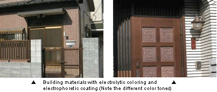

The most frequent users of electrolytic coloring in our country are building material manufacturers, thus you see window sashes, entrance doors, roofs, and fences, for example, that have been treated. In general, bronze is the most popular color, and a transparent electrophoretic coating is added after coloring to increase the corrosion resistance of the building materials.
