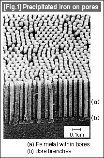

For data storage media such as floppy disks, magnetic material coating application is generally used. However, the magnetic material embedding in surface pores has 2~3 times higher magnetic properties than the former. The [Fig.1] shows an example of a magnetic material with iron deposited by a secondary electrolysis where the surface coating layer dissolved away for the observation purpose.

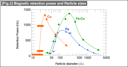

As the magnetic retention power is influenced by the size of the magnetic material particles as clearly shown in [Fig.2], it is said that the data storage capacity can be increased by enlarging the surface pore diameter by an enlarging process.

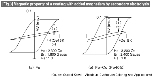

[Fig.3] shows the magnetic property of a coating with added magnetism by secondary electrolysis.
