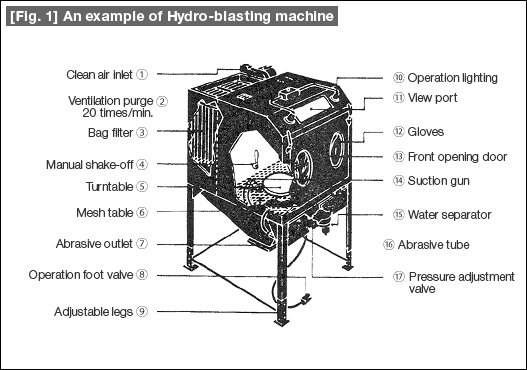

Silica sand, steel grits and glass beads are air sprayed or projected with rotating wheels (Centrifugal projection) - Hydro blasting
Alumina and silicon carbide particles mixed in water are sprayed ([Fig.1]) - Other, Tumbling barrels, rotary wire brush, etc.
![[Fig.1] An example of Hydro-blasting machine
[Fig.1] An example of Hydro-blasting machine](http://www.misumi-techcentral.com/tt/en/surface/images/105.gif)
