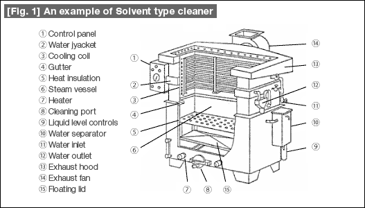

- Steam cleaning (Dissolving power is increased when the solvents are vaporized but will require vapor recovery system) Shown in [Fig.1]

![[Fig.1] An example of Solvent type cleaner [Fig.1] An example of Solvent type cleaner](http://www.misumi-techcentral.com/tt/en/surface/images/106.gif)
