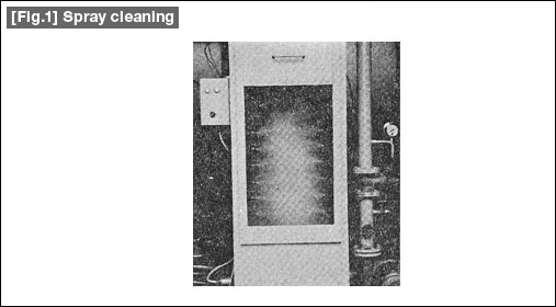

Since the process relies on chemical reactions, the agents are used in various water solution forms in submerged, sprayed ([Fig.1]), tumbled (in barrels), electrolytic cleaned (anodic/cathodic electrolysis), wiped on, ultrasonic cleaned (ultrasonic vibrations used while submerged), and etc. In order to accelerate the chemical reactions, the solutions are heated (to 40~60°C).![[Fig.1] Spray cleaning [Fig.1] Spray cleaning](http://www.misumi-techcentral.com/tt/en/surface/images/107.gif)
