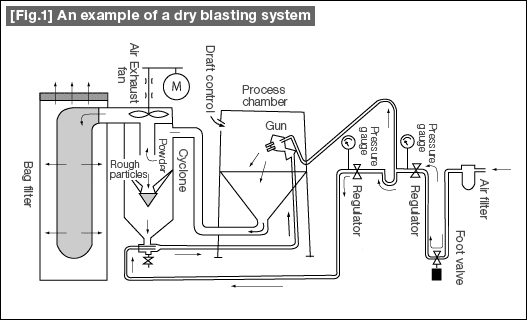

An example of a dry blasting system is shown in [Fig.1].
![[Fig.1] An example of a dry blasting system [Fig.1] An example of a dry blasting system](http://www.misumi-techcentral.com/tt/en/surface/images/117.gif)
An object is placed in the process chamber and the abrasive is sprayed on the surface while keeping the gun tip at proper distance from the object. The spent abrasive material is sent to the cyclone and reusable portion is recycled. The removed powdered material is trapped by the bag filter. As shown, the process chamber is a sealed steel box and the gun is typically fixed stationary. There is a glass window and a pair of rubber gloves on the front side, and the operator holds the work piece with the gloves and apply the process using the foot valve.
There are dry methods where compressed air is utilized to spray the abrasives as well as methods that project the abrasives with blade type devices similar to windmills. This method is used for objects too large to fit inside the process chamber.
