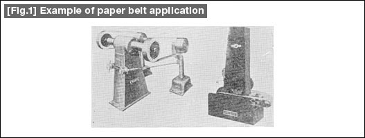

[Fig.1] is an example of a buffing lathe with contact wheels as abrasive surfaces, and is the most fundamental configuration. The figure on the right is a vertically configured simple semi-automatic machine of the same with a feed belt as the abrasive surface.

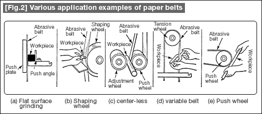

[Fig.2] shows a various applications of paper belts. The center-less application in the figure can easily automatically grind round objects such as rods and pipes by the adaptation of a simple adjustment wheel. The variable belt application figure shows the ability to grind difficult to access inside surfaces.
