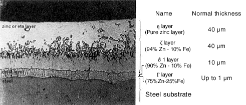

After the pretreatment process, dip the product into a bath of molten zinc around 460°C. Wait for an appropriate length of time, and then lift the product up from the molten zinc bath after removing zinc oxide particles floating on the surface.After allowing excess molten zinc to drip off by applying light impact, cool the product.
As shown in the cross-section image above, the plating film consists of a zinc layer on the top and an alloy layer formed by the reaction of molten zinc with steel.The thickness and composition of an alloy layer are determined by the chemical composition of steel and operating conditions. The thickness of the topmost zinc layer is determined by factors such as the bath temperature and speed of withdrawing the product from the plating bath.

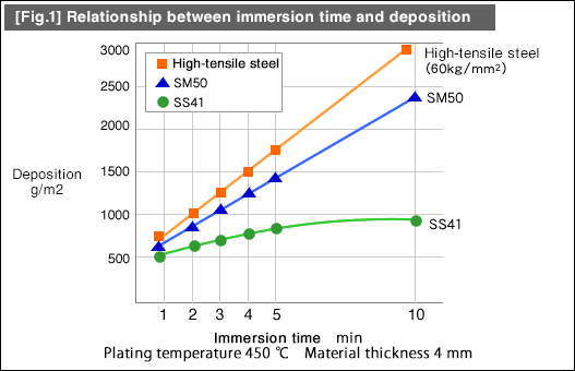

(2) Immersion time
In general, the longer the immersion time, the greater the amount of zinc deposition is.[Fig.1] shows the deposition conditions for general steel and high-tensile steel materials.
