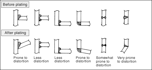

Residual stress that occurs during the production process of the steel products is released by plating heat, which causes distortion to appear on the product.From the commercial point of view, it is necessary to consider whether the degree of distortion is within the permissible limit and corrections are needed or feasible.The figure below is a specific example of distortion caused by welding methods.
