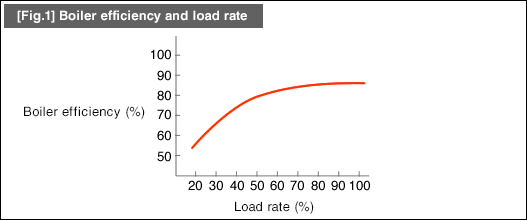

Recent boilers are more efficient than the conventional ones. You may see "thermal efficiency 98%" in the product catalog. However, this efficiency value can only be achieved at the optimum operating state during continuous operation.Such efficiency cannot be achieved during actual operation.This is because the load rate of a boiler fluctuates depending on the operating condition.
For example, when a surface treatment plant starts its operation, steam needs to be supplied continually to heat a degreasing bath or a plating bath. Once the bath temperature has risen to a certain temperature, the bath no longer needs that much steam since the high specific heat of these solutions minimizes the temperature drop.
In this case, the boiler operates at an extremely high efficiency with the load rate of 100% around the time of starting daily operations. Once the surface treatment work enters into a steady operation cycle, the boiler operates at low load with decreased efficiency as the burner intermittently burns fuel.In other words, the boiler releases more heat into exhaust gas during low-load operations.
[Fig.1] shows the relationship between the efficiency and load rate of a boiler.
