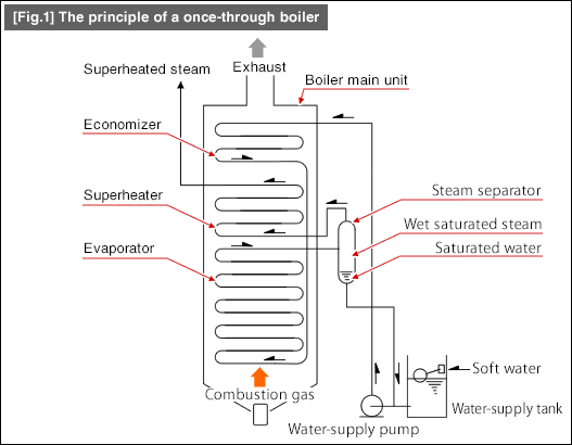

[Fig.1] shows the principle of a one-through boiler. The exhaust heat recovery area called the 'economizer' preheats water pumped through boiler water tubes. The water starts boiling in the tubes while it circulates from the lowest-temperature to the highest-temperature area in the combustion chamber. At this time, water and steam coexist. The water and steam mixture is sent to the steam separator where water droplets are removed from the steam by gravity. The water droplets are then transported back to the water-supply pump.
Heating up the steam separated from the water at a temperature higher than its vaporization point generates "superheated steam" to be supplied to a heating object through the main steam valve.
