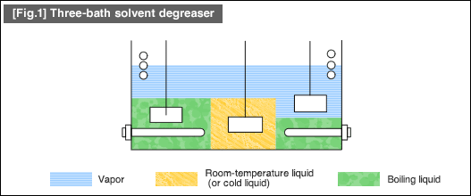

This is a solvent degreasing method that has been in use since the old times.In the past, trichloroethylene (TCE) and perchlorethylene (PCE) were used for this purpose. However, their use and production have been banned due to their toxicity.Currently, the following types of solvent are used for metal cleaning:
| (1) | Aliphatic hydrocarbon --- Petroleum solvent |
| (2) | Aromatic hydrocarbon --- Coal tar solvent |
| (3) | Non-combustible solvent --- Chlorinated hydrocarbon |
| (4) | Polar solvent --- Ketone, Alcohol, and Phenol |
These solvents are processed by a dedicated solvent degreaser and used in the following forms: vapor degreasing, liquid degreasing, and a combination of both as the most common method.(See [Fig.1]) First, clean a room-temperature workpiece in the vapor-phase tank filled with solvent vapor. As the temperature rises up to the steam temperature, cool it off with the room-temperature solvent. Then, heat up and dry the workpiece in the vapor-phase tank.

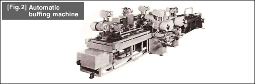

| (2) | Polishing and machining --- The most common method is buffing. Finish the surface as desired.([Fig.2]) |
