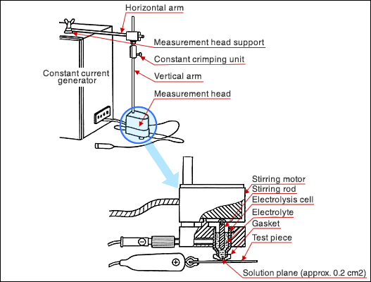

(1) Measurement principle
Set the electrolysis equipment (measurement head) on the plating surface. Pour the electrolyte and polarize a specified area of the plating surface. Electrolysis at constant current dissolves the plating. In this method, the plating thickness is measured by the electricity consumed for this process. The amount of metal dissolution (plating thickness) is proportionate to the time in the constant current dissolution. Therefore, the time required for electrolysis represents the plating thickness.
(2) Equipment
The measurement equipment is comprised of the constant DC current supply unit, electrolytic head (consisting of an electrolytic bath, a stirring device, retainers, etc.), and measuring unit.
In order to prevent liquid spill and to keep the electrolysis area constant, a gasket is installed at the bottom end where the plating surface contacts the electrolytic bath. A gasket for the 0.2cm2 area of electrolysis is generally used.
Since the electrochemical equivalent varies by the type of the plating metal, it is possible to select a constant current value unique to each metal.
