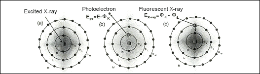

(1) Measurement principle
Atoms comprising a substance have their unique core electron level. Emitting X-ray, γ-ray, or electron beam to this atom generates the X-ray with characteristics unique to that atom (so called "characteristic X-ray"). This X-ray is called fluorescent X-ray. The energy (wavelength) is known to correspond with difference of atom's core electron level, which is equal to the characteristic energy transferred between the atom shells.
The fluorescent X-ray analysis analyzes the type and volume of atoms present in a substance by using this fluorescent X-ray. The qualitative analysis identifies the type of atoms while the quantitative analysis measures the contained amount.
