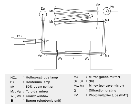

(2)Measurement device
The figure here is an example of the optical system for an atomic absorption photometer. Use an appropriate type of a hollow-cathode lamp (HCL) for the atom absorption wavelength you are going to measure. The deuterium lamp (D2) is used for background correction. Substances such as hydrogen, acetylene, and nitrous oxide are used for the heat source of the burner (B) to bring atoms to the excited state. Inject the sample in a mist form into this burner. The light passed through the burner flame is converted into an electric signal by the photomultiplier tube (PMT), which will be displayed and printed out as the concentration data.
