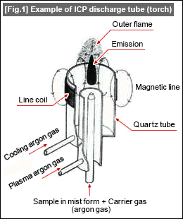

| The analysis equipment is comprised of the followings: emission unit (for vaporizing sample and emitting light), spectroscopic unit (for dispersing emission spectral lines), and photometry unit (for measuring spectral lines). [Fig.1] illustrates the structure and mechanism of an ICP discharge tube. The plasma discharge tube has a three-layered structure made of quartz. A coil is wired on the top. A high-frequency magnetic field is induced by passing high-frequency current through the coil. If you add argon gas here, it will generate high-temperature plasma flame. Place the sample prepared a mist form by a nebulizer (atomizing device) onto a flow of argon gas. Once the gas has flown into the plasma flame, light emission occurs after vaporization, atomization, and excitation processes. Analyze this emission spectrum by the spectroscopic and photometry units. |

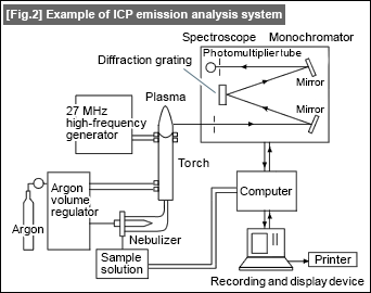

| [Fig.2] illustrates the analysis equipment system. | ![]() |
