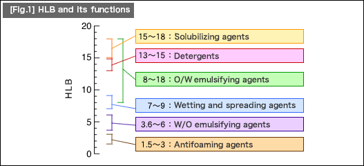

(1)HLB (Hydrophile-Lipophile Balance)
Surfactants have a structure comprised of lipophilic group (reaction group easily bonds with fat) and hydrophilic group (reaction group easily reacts with water). The HLB is an indicator of these balance. [Fig.1] shows the HLB and its functions.
An HLB value of zero corresponds to the most lipophilic molecule, and an HLB value of 20 corresponds to the most hydrophilic molecule. All surfactants are placed between these values, and each value represents its respective property.
Surfactants with an HLB value of five or less will be emulsified and dispersed into water without being dissolved. With an HLB value of 10 or more, surfactants appear to be dissolved in water as it produces a clear solution. However, at this time, most of the surfactant molecules aggregate in water as micelles.
"O/W emulsifying agents" in the figure is a state where oil is dispersed in water. Milk is a typical example of this type (milk fat is dispersed into water). "W/O emulsifying agents" is a state where water is dispersed into oil, as in butter or margarine, for example.
