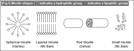

(3) Micelle formation
Most of the remaining surfactant molecules will aggregate micelles with their hydrophilic head regions in contact with water so that they can minimize the unstable free energy after failing to obtain an adsorption interface. As shown in [Fig.1], micelles are formed in various shapes, such as spherical, layered, rod, and small micelles.
Most of the molecules are found in the form of a micelle in the surfactant solution. In addition, a small amount of surfactant molecules and adsorbed molecules at an interface also exist.

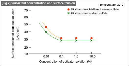

(4) Surface tension reduction
The surface tension is the amount of free energy stored between air and solution. The interfacial tension is the amount of free energy stored per unit area between dirt particles and solution. As the amount of surfactant increases, the surface tension decreases (it becomes saturated at a certain point). As a result, it makes the dirt dissolution, emulsification, and suspension easier. [Fig.2] shows the relationship between the surfactant concentration and surface tension.
Reduction of surface tension not only brings about the effect mentioned here but also prevents plating solution from being pumped out or avoids mist generation.
