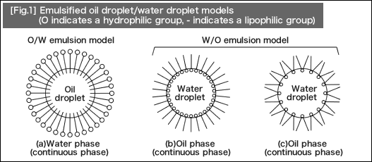

(5)Emulsification
Surfactant solution emulsifies and disperses lipophilic dirt in a liquid form into fine and stable small drops. Molecules of the surfactant adsorb hydrophobic groups into an oil droplet. The product resulting upon this process is O/W (oil-in-water) emulsion. [Fig.1] (a) shows the image.
On the other hand, when a water droplet is emulsified in oil-based liquid, W/O (water-in-oil) emulsion will be formed. This type of emulsion is shown in [Fig.1] (b) and (c). In general, "emulsion" refers to the emulsified materials described here.
