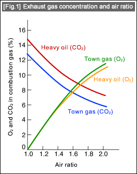

However, complete combustion is not possible at the theoretical air volume in actual combustion processes. Unburned fuel will be emitted as black smoke and discharged from a chimney. This is due to an inefficiency of combustion burners. Burners currently available are not capable of achieving complete combustion.
To eliminate the emission of black smoke, it is necessary to feed more volume of air than the theoretical requirements for combustion. However, excess air will lower temperature inside the furnace and will increase the exhaust gas temperature and heat loss. The combustion management required here is called 'air-ratio control'.
From [Table 1], fresh air fed in the boiler contains 21% of oxygen. The concentration decreases because this oxygen will be consumed in the combustion process. The concentration of consumed oxygen can be determined by measuring oxygen concentration in the exhaust gas. ([Fig.1])
Calculate the air ratio by the following formula:
The air ratio is generally managed at 1.3. Besides the oxygen concentration, the air ratio is also controlled by the CO2 concentration increased by combustion.
