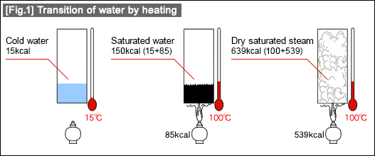

[Fig.1] illustrates the process of room temperature water turning into steam. First, prepare water at 15°C in an airtight container. Then, heat the container. The water temperature gradually rises and starts boiling when it reaches at 100°C. If you keep heating it, water evaporates into steam although the temperature stays the same. Once all the water evaporates into steam, the temperature starts rising again. The heat quantity used to be described in units of kilocalories (KCal), but using kilojoules (KJ) is more common nowadays.

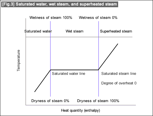

![[Fig.3] Saturated water, wet steam, and superheated steam [Fig.3] Saturated water, wet steam, and superheated steam](/tt/en/surface/279_3.gif)

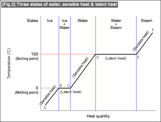

[Fig.2] shows the relationship between water and heat when this phenomenon occurs. In this phenomenon, heat transforms water into three states: ice (solid), water (liquid), and steam (gas). There are two types of heat: sensible and latent heat. Sensible heat is in a form of heat energy that can be measured by thermometers whereas latent heat cannot be measured by such instruments. In addition, the steam in the right container shown in [Fig.1] can be in various forms as explained in [Fig.3].
Boiling water and steam coexist in a boiler. This steam is called "wet (moist) steam". The latent heat of this steam changes by the quantity of heat energy applied.
In addition, the moisture content of steam is called "wetness". When the wetness becomes 0%, the steam turns into a form called "superheated steam" and the steam temperature increases by heating.
