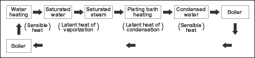

As described in the previous volume, the heat circulates in the heating system of plating bath. See the figure below.
fig
Indirect heating is a common method for heating plating bath in general, such as using a heater with corrugated tubes or a heat exchanger to circulate plating solution in a pump. Therefore, the latent heat of condensation of water is the only heat effectively used in this heating system.
Now, suppose you have used the steam with the gauge pressure 0.2 MpaG. In this table, the total heat is 2,725 KJ/kg for 1 Kg of steam, but the heat quantity available for heating the plating bath is only 2,163 KJ/kg.
