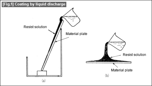

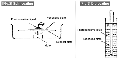

An infrared lamp or hot air at 60 to 90°C will be used for drying and removing the solvent after applying a photoresist. However, if you dry it too fast, it dries only the surface and leaves bubbles, which will turn into pinholes later or will result in degraded adhesion. [Fig.1], [Fig.2], and [Fig.3] are the illustration of coating by liquid discharge, spin coating, and dip coating, respectively.

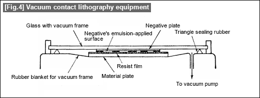

Place a negative film on top of the base plate with a photosensitive film applied. To improve the adhesion to masks, put this assembly into vacuum contact lithography equipment for light exposure.
Use a carbon arc lamp, a high-pressure mercury lamp, a xenon lamp, or laser light as the light source for exposure.
The photosensitive area of photoresists covers ultraviolet regions and visible parts. Use vacuum contact to adhere the resist-applied surface to the emulsion-applied surface before exposing them to light. [Fig.4] is an image of vacuum contact lithography equipment.
