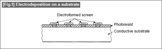

If you use a glass substrate, it is necessary to make its surface conductive. To add conductive properties, it is common to form silver, copper, or nickel coating by electroless plating, cathode DC sputtering, or vacuum deposition. Copper and nickel are frequently used for electrodeposition in photo electroforming. The bath composition and electrolysis conditions are same as those for general electroforming. [Fig.1] illustrates the electrodeposition onto a substrate using a photoresist.

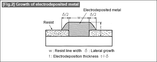

[Fig.2] shows how the electrodeposited metal grows. The deposited metal grows up to the height of the resist layer; however, the excess metal deposited after that starts growing in the lateral direction. This lateral growth becomes the margin of error for the pattern. The length of lateral growth on both sides (δ) is almost equal to the thickness of the electrodeposited layer (t). Therefore, this dimensional adjustment must be incorporated into the original drawing.
