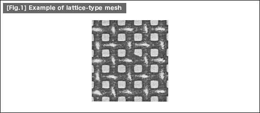

The shapes and dimensional accuracy of meshes produced by electroforming include the following: a lattice-shaped mesh containing 4 to 80 wires per 1 cm, a fine mesh containing 8,000 to 160,000 holes in 1 cm2, a mesh with different number of vertical and horizontal wires, 40 wires per cm x 80 wires per cm, for example.
![[Fig.1] Example of lattice-type mesh](http://www.misumi-techcentral.com/tt/en/surface/498.jpg)
