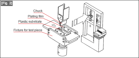

(2)Method of adhesion test
This testing uses a tension tester to measure the adhesion strength of plating quantitatively when the plating film is peeled off from the substrate. This method is also known as the peeling test method.
1)Sample preparation
2)Test operation
| 1. | As shown in [Fig.2], place the test piece onto the tension tester using a fixture for test piece. | |
| 2. | Pull the tester as fast as 25mm/min by setting the peel strength at 5 N/cm and strip off the plating evenly at right angle. |
![[Fig. 2] [Fig. 2]](/tt/en/surface/092_2.gif)
(3)Simplified method of adhesion test
This test is a simplified method of measuring the adhesiveness when the plating is separated from the substrate using a spring balance. Using a spring balance having the minimum scale of 20 g, secure the sample on the balance and attach the fixture for the test sample as shown in [Fig.3]. Then, peel off the plating.Read the value when the plating is separated. |
