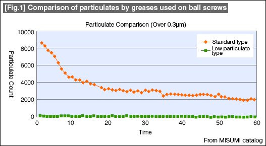

![[Fig.1] Comparison of particulates by greases used on ball screws [Fig.1] Comparison of particulates by greases used on ball screws](http://www.misumi-techcentral.com/tt/en/lca/images/119_02.gif)
From [Fig.1]
| ・ | Since ball screws have rotating motion, they have great effects of splashing grease. In general, a lot of standard grease would be splashed for the first 20 hours, then the splashing would remain stable at high levels. |
| ・ | Low particulate grease would have small initial splash amounts and remain stable for long duration. |

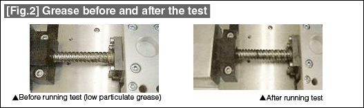

| ・ | For both grease types, proper greasing maintenance is required. (see [Fig.2]) |
![[Fig.2] Grease before and after the test [Fig.2] Grease before and after the test](http://www.misumi-techcentral.com/tt/en/lca/images/119_03.jpg)
