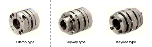

New products: Characteristics of high rigidity disc couplings
![]() | * | Product compatible to servo motors with excellent high speed and accurate controllability. |
![]() | * | Due to their disc configuration, they have virtually zero backlash, but have high flexibility in shaft misalignments such as angular and shaft center misalignments. Easy to accomplish shaft aligning work. |
![]() | * | The clamp style mounting eliminates a need to machine the shaft for keys. No concerns for shaft strength degradation. |
New product: High rigidity disc style couplings
