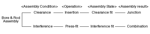

Assembling bores and rods are classified into two assembling procedures based on the dimensional relationship between the two parts.
Here, the glossary of press-fitting that requires forces for assembly is explained.
[Table 1] Glossary of press-fitting work
Explanation on press-fitting procedures
- Press-fitting is a procedure to fit two parts of a shaft diameter and a bore diameter where a targeted interference is utilized by spreading by the parts fit.
- The surface pressure and friction of spreading this interference apart is applied as the press-fitting pressure. The way to apply this press-fitting pressure classifies the press-fitting operation.
- Obtaining of this press-fitting pressure requires some preparation operations with associated difficulties such as accurate locating of two parts and managing of gripping forces, but the press-fit pressure would commensurate the resultant parts combing reliability.
