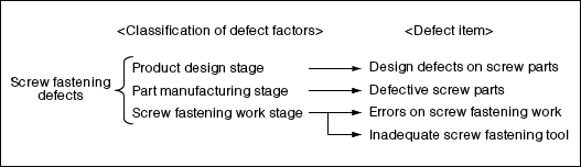

(1)Screw fastening defects and the factors classified
Screw fastening defects can be classified as the following.
Of the above, below are the screw fastening device related defects.
