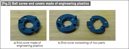

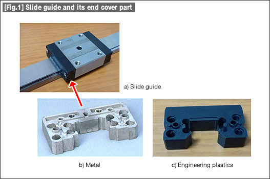

·For FA automation parts, engineering plastics have been adopted for retainer parts used to change the direction of ball screw bearings in the circulation zone.
![[Fig.1] Slide guide and its end cover part [Fig.1] Slide guide and its end cover part](http://www.misumi-techcentral.com/tt/en/lca/465_1.jpg)
![[Fig.2] Ball screw end covers made of engineering plastics [Fig.2] Ball screw end covers made of engineering plastics](http://www.misumi-techcentral.com/tt/en/lca/465_2.jpg)
