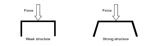

The last two units mentioned here are the mechanical components strongly related to static mechanics without involving motion. Understanding forces, resultant forces, or resolution of forces will improve design quality of the mechanical components.

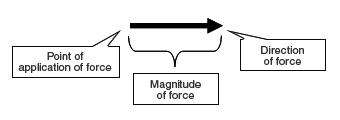

- The state of force is expressed by the point of application and the line of action indicating the force direction. The magnitude of force is expressed by the length of the line of action. The arrow indicating all of these elements is called a "vector".
- Symbol N (Newton) indicates the magnitude of force. 1 N is equal to the force needed to accelerate a 1 kg mass at a rate of 1 m/s².

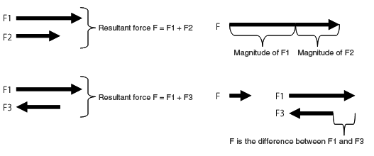

(3)Composition of forces
- In general, multiple forces are applied to a mechanical component. The effect of these forces combined can be expressed as the single force. The combined force here is called a "resultant force".
Resultant force along the same line of action
