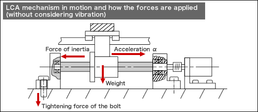

- For linear motion mechanism, it is necessary to design a control unit that applies a force to the opposite direction after reducing acceleration to zero at the termination point where the direction of reciprocating motion changes.
- This acceleration change requires an external force. At this time, the force of inertia acts near the termination point of reciprocating motion.
- Therefore, it is necessary to design a support structure strong enough to withstand the force of inertia.
- The following figure is an explanatory diagram of how the forces are applied to the ball screw driving mechanism.
