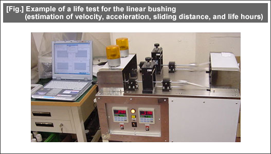

Velocity and travel distance are used for estimating work tact (time) or life hours relative to the sliding distance when designing a linear motion mechanism. They are also utilized for assessing the moment of inertia force.
![[Fig.] Example of a life test for the linear bushing (estimation of velocity, acceleration, sliding distance, and life hours) [Fig.] Example of a life test for the linear bushing (estimation of velocity, acceleration, sliding distance, and life hours)](/tt/en/lca/492_1.jpg)

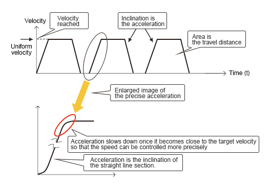

(2) Motion expressions
The following figure shows a relationship between the time and speed of uniform motion. It is a typical pattern of linear motion (linear reciprocating motion).
