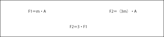

- When "m" represents this proportional multiplier, the second law of motion can be expressed as F = m・A. This formula is called "equation of motion".

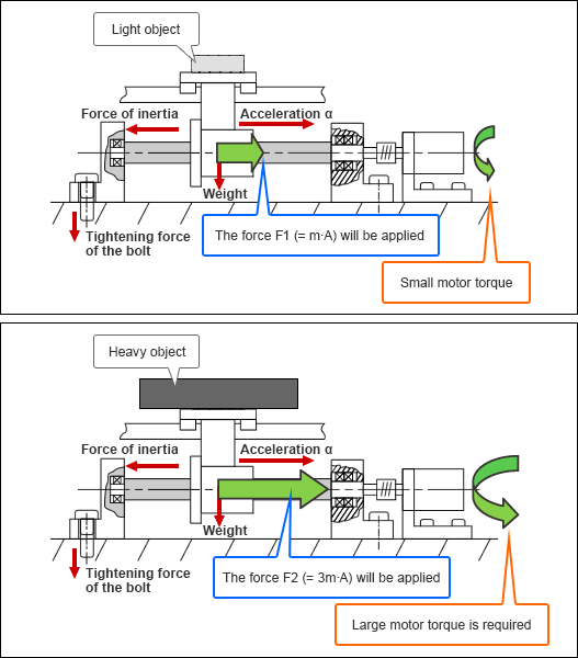

- Depending on the load weight transported on the movable table, the required capacity of a rotary motor varies in order to generate the same acceleration in the linear drive mechanism.
- When the load mass in the left figure is m, the load mass in the right figure is three times more than m (= 3m), the driving force on the right needs to be three times more than the left mechanism in order to generate the same acceleration.
- Therefore, the weight reduction technique is required as an important technique for designing high-speed drive mechanisms.
