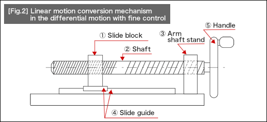

[Fig.2] shown here has a different screw structure to [Fig.1].
Moving the shaft connected to the handle by one pitch can create differential motion from the slide block movement. In other words, single rotation of the handle will move the shaft the distance of screw pitches towards the left side. Simultaneously, the slide block moves the distance of screw pitches in the reverse direction of the shaft movement (towards the right side). Since the relative motion of the shaft and slide block here is equal to the difference (differential motion) of these two movements, precise adjustment on the movement is possible. A fine thread screw has been adopted for the slide block parts in [Fig. 2]. However, using a screw with the same pitch as the right one can still produce the fine movement because this mechanism works by the differential motion.
Application examples
| 1. | Auxiliary positioning mechanism for inspections using a magnifying microscope or positioning work. | |
| 2. | Precision positioning mechanism | |
| 3. | Speed reducer |
