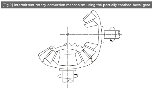

(2)Typical example of this mechanism
[Fig.2] illustrates an application that uses the partially toothed shape of a bevel gear.
While the intermittent rotary conversion mechanism shown in [Fig.1] is a power transmission between the parallel axes, the transmission mechanism shown in [Fig.2] changes its axis direction to 90 degrees. To design this mechanism, remove a part of the teeth on the driving shaft of a bevel gear and process this part to have a conical surface. For the other gear as well, process the area that contacts the missing tooth part to have the same finish. Rotary motion occurs in the toothed area, but the gear wheel on the driven shaft side will stop when the missing tooth part is in contact with the other gear, thus transmitting intermittent motion.
