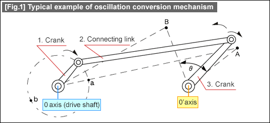

[Fig.1] is a typical diagram of this mechanism. The basic mechanism design is explained by using this mechanism.
![[Fig.1] [Fig.1] Typical example of oscillation conversion mechanism](/tt/en/lca/086_1.gif)
When a crank (1) is connected rotating around the 0 axis (drive shaft) to another crank (3) that will swing around the other rotation shaft called the 0' axis using a connecting link (2) in the link mechanism, the crank (3) starts swinging from side to side as the crank rotates around the 0 axis by one turn. At this time, the swinging range of the crank (3) (from point A to B) is determined by the position where the crank (1) and the connecting link (2) are arranged in a straight line.
In [Fig.1], the two components are arranged in a straight line at point a. The swinging crank (3) inverses its motion after reaching point A located on the right edge. Again, they are arranged in a straight line at the point b, which determines the swinging range point B.
