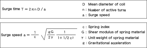

| - | When a coil spring absorbs shock, the coil wire undergoes torsion, which is transmitted as a shock wave. This shockwave is called a surge wave. | |
| - | The amount of time (T) in which this surge wave moves along the spring wire and travels back is called surge time. The surge time and speed can be calculated using the following formula:![]() | |
| - | When a coil spring is subject to forced oscillation, the resonance phenomenon surging occurs if the cycle corresponds to the surge time T or becomes the half or one third of the surge time T. |
