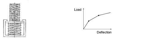

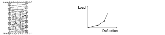

(a) Combination springs
Multiple helical compression springs connected in series and load-deflection characteristics
Multiple helical compression springs stacked in combination and load-deflection characteristics

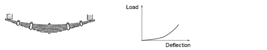

(b) Leaf springs
Bonded leaf springs with sliding support unit on both ends and load-deflection characteristics

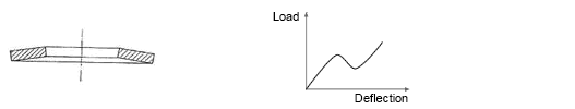

(d) Disc springs
Disc spring and load-deflection characteristics

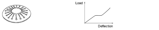

(e) Diaphragm springs
Diaphragm spring and load-deflection characteristics

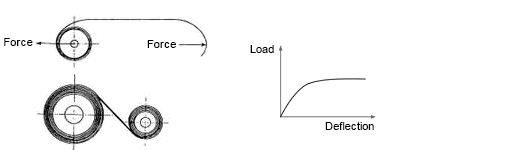

(f) Constant force spiral springs
Constant force spiral spring and load-deflection characteristics
(g) Constant force springs
Constant force spring and load-deflection characteristics
