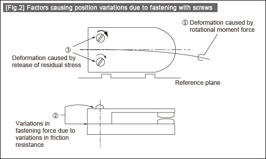

・ The positioning with use of fastening screws will inevitably cause factors for positioning errors as listed below (Fig.2).
(1) Deformation of parts caused by the rotational moment force generated by the tightening torque of fastening screws
(2) Variations in applied clamping force due to variations in friction resistance on the contact surface clamped by fastening screws
(3) Deformation caused by residual stress and its release of tightening torque
・ Those listed above in (1) through (3) will greatly depend on the number and arrangement of fastening screws.

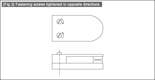

・ One of the solutions to (1) and (3) includes tightening two fastening screws in opposite directions. Even in this case, the accuracy of positioning will be limited to a certain level due to differences in timing of tightening two screws and/or other factors (Fig.3).
