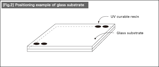

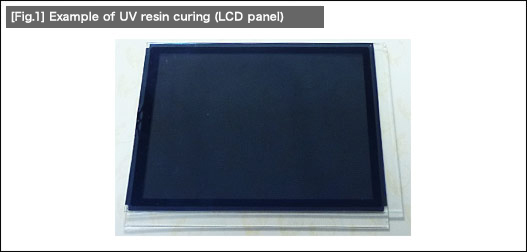

-UV curable resin is a common material used for adjusting the position of two aligned components. (Fig.1 and Fig.2)
-Adopting the UV curable resign is beneficial in terms of the following:
1) The time required for resin curing can be shortened.
2) Thermal deformation during resin curing can be avoided.
3) When using a UV permeable material (such as a glass substrate),
the resin can be cured on the backside.

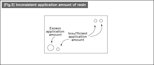

a) Inconsistent application amount of UV curable resin (Fig.3)
(Too little: Lack of strength. Too much: Dislocation caused by variations
in cure shrinkage)

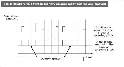

-Variations in the resin application amount are generally resulting from uneven spraying from the resin dispenser. This phenomenon occurs due to the following: i) Inconsistent viscosity of the resin; ii) Varying conditions of the resin being applied (such as viscosity, resin conditions at the dispenser head, and so on) due to changes in application pitches; iii) Changes in the properties of the resin itself.

-Unstable spraying positions are generally attributable to the positioning accuracy of the workpiece being sprayed and the direction of resin released from the dispenser.
