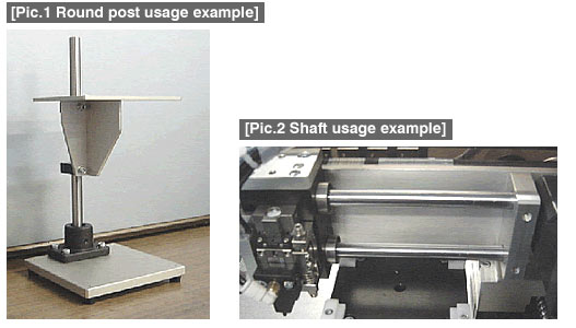

[Pic.1][Pic.2]

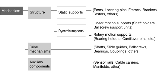

Organizing LCA mechanisms
The LCA is comprised of the following configuration, and this establishes the reference for the components' functionality.
LCA = Mechanism + Actuator + Controller
images
Structural member is: Non-moving mechanical elements that support the entire mechanism. Drive mechanism is: Moving mechanical elements.
In order to make proper product selections from the catalog, it is important to understand the specific characteristics of the listed components. We will explain the characteristics of the standard components using visual information such as photos and pictorials, hereafter. Usage examples of shafts will be explained with pictorials next.
