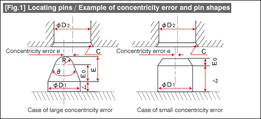

When designing automated assembly systems using a various fixtures, careful considerations for shaft/bore fits along with locating pin/hole shapes and configurations are needed.
Principles of locating feature designs
| * | Adequately chamfer the pins holes to facilitate smooth pin entry. | |
| * | Two constraint points cannot simultaneously exist per one insertion action. | |
| * | Extraction action must also be considered when designing. |
[Fig.1] shows typical configurations of locating pins and locating holes. Subjects related to the locating parts are as follows.
| 1. | Required position locating accuracy. | |
| 2. | Assembler/apparatus accuracy. (Degree of work difficulty or ease, etc.. Machine accuracy.) | |
| 3. | Assembled parts accuracy. (Case of high accuracy parts, or variable accuracy parts, etc.) | |
| 4. | Workability of parts such as contacting surface length, etc. (Relationship between produceability and accuracy, etc) |
Locating pins / Example of concentricity error and pin shapes" name="image" width="527" height="240" />

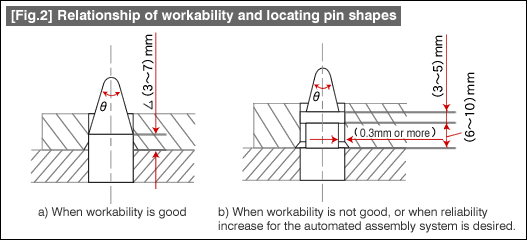

Locating pin/hole design in [Fig.1] is to be proceeded with the following.
Locating pins
![[Fig.2] Relationship of workability and locating pin shapes](http://www.misumi-techcentral.com/tt/en/lca/images/020_2.gif)
Locating holes
