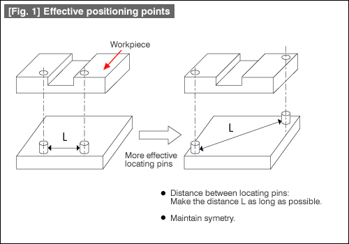

| 2. | Place two objects in a configuration where their positional relationship is set in an effective manner (refer to [Fig. 1]).
Example: 1) Keep two dowel pins for positioning as far apart from each other as possible 2) Set the dowel pins in symmetrical positions ![]() | |

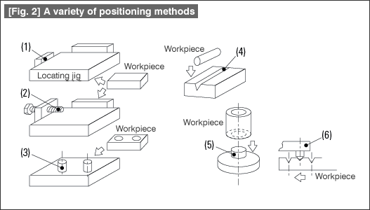

(2) A variety of positioning methods
Positioning methods are classified as shown below (refer to [Fig. 2]).
![[Fig. 2]](http://www.misumi-techcentral.com/tt/en/lca/images/v182_2.gif)
