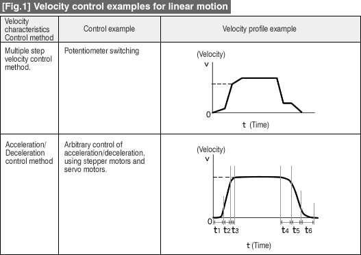

(2) Velocity characteristics (see Fig.1)
![[Fig.1] Velocity control examples for linear motion](http://www.misumi-techcentral.com/tt/en/lca/images/032.gif)
In order to shorten the positioning time and achieve high positioning accuracy, component deformation produced by inertial force (inertial torque) must be reduced. To do this, acceleration (α) needs to be made as small as possible. However, the rise/fall times will become or make longer if acceleration (α) is simply reduced. A countermeasure for this is a multi-step velocity control method where acceleration is reduced to near zero at the start and the end, and largely increased during acceleration/deceleration.
(a) Multi-step velocity control method
This is one of the methods to achieve higher positioning accuracy at an intermediate position stop. By reducing the velocity in multiple steps as the target position approaches, the effects of decelerating load inertia is reduced. The multi-step velocity settings can be pre-programmed as high/med/low speeds, or motor pole counts can be sequentially switched to do this.
(b) Acceleration/Deceleration control method
This is a method where acceleration is reduced to near zero at the start and the end, and largely increased during acceleration/deceleration.
