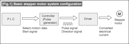

(2) Stepper motor system configuration
A system configuration comprised of: PLC (Programmable Logic Controller) + Stepper motor controller + Stepper motor driver + Stepper motor is needed to control the rotation of a stepper motor (see [Fig.1]).
![[Fig.1] Basic stepper motor system configuration](http://www.misumi-techcentral.com/tt/en/lca/images/034_1.gif)

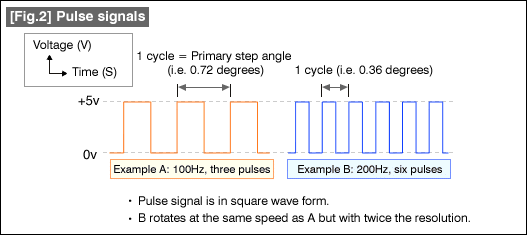

Programs in the PLC are converted into pulse signals (see [Fig.2]) in the controller, then converted into motor controlling electrical current in the driver.
![[Fig.2] Pulse signals](http://www.misumi-techcentral.com/tt/en/lca/images/034_2.gif)

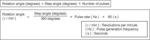

(3) Motion controlling method
Rotation angle and speed are calculated by the following equations.
Example
Case for: Step angle:0.72 deg., Pulse rate: 100Hz... 12(r/min)・・・ 12 rotations per minute Case for: Step angle:0.72 deg., Pulse rate: 1000Hz... 120(r/min)・・・ 120 revolutions per minute
